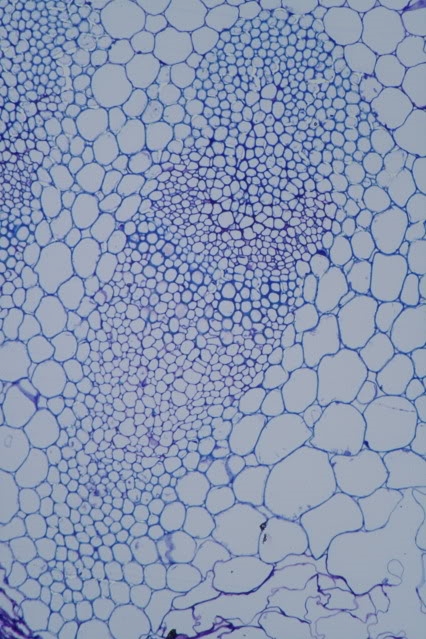

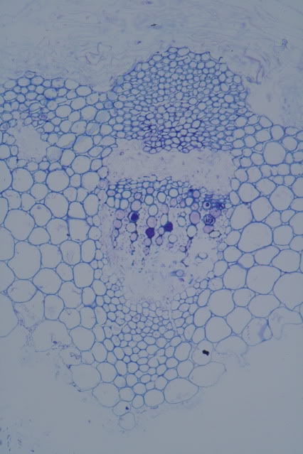

I always thought that bacterial infection of flower stems led to clogged vessels. No water transport and wilting as a consequence. It took these Gerberas just 3 days to wilt. Of course dirty, bacterially infected water. Histology showed a surprise: all the phloem had disappeared.
Normal vessel . obj.10x
Diseased vessel obj 10x

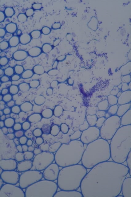

And diseased vessel at 20x obj.
Technovit 7100 and toluidine blue stain.
I did not enjoy the flower's fate. But the pathology is impressive.

Dear Leo,
thank You for the interesting sections!
I asume, that the saccharid concentration in the Phloem is responsible for the growth of bacteria and the following destruction of the tissue.
Regards
Florian Stellmacher
Dear Leo,
very impressive - and quite similar to several things happening to human tissue in infectious disease.

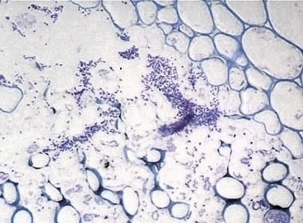

I tried to identify the causative organism by enlarging your photograph, and there seams to be a mixed flora of rod shaped and coccoid bacteria.
Presuming your accordance, here an enlarged detail of your photograph (of cause in reduced resolution):
An additional photograph in higher magnification/x100 oil immersion would be interesting!

Dear Florian,
Thank you for your picture. Our immune system is  quite a bit better than that of a (cut) plant, usually.
I did the 100xoil. In the xylem the form may not be representative because of sitting in a tube . In between parenchymous cells  I found a better collection and .
The latter 2 seem to reflect rod-shaped bacteria, because this is a section where the rods are seen in all directions from circle to rod. Could however be different to what's present in the xylem.
