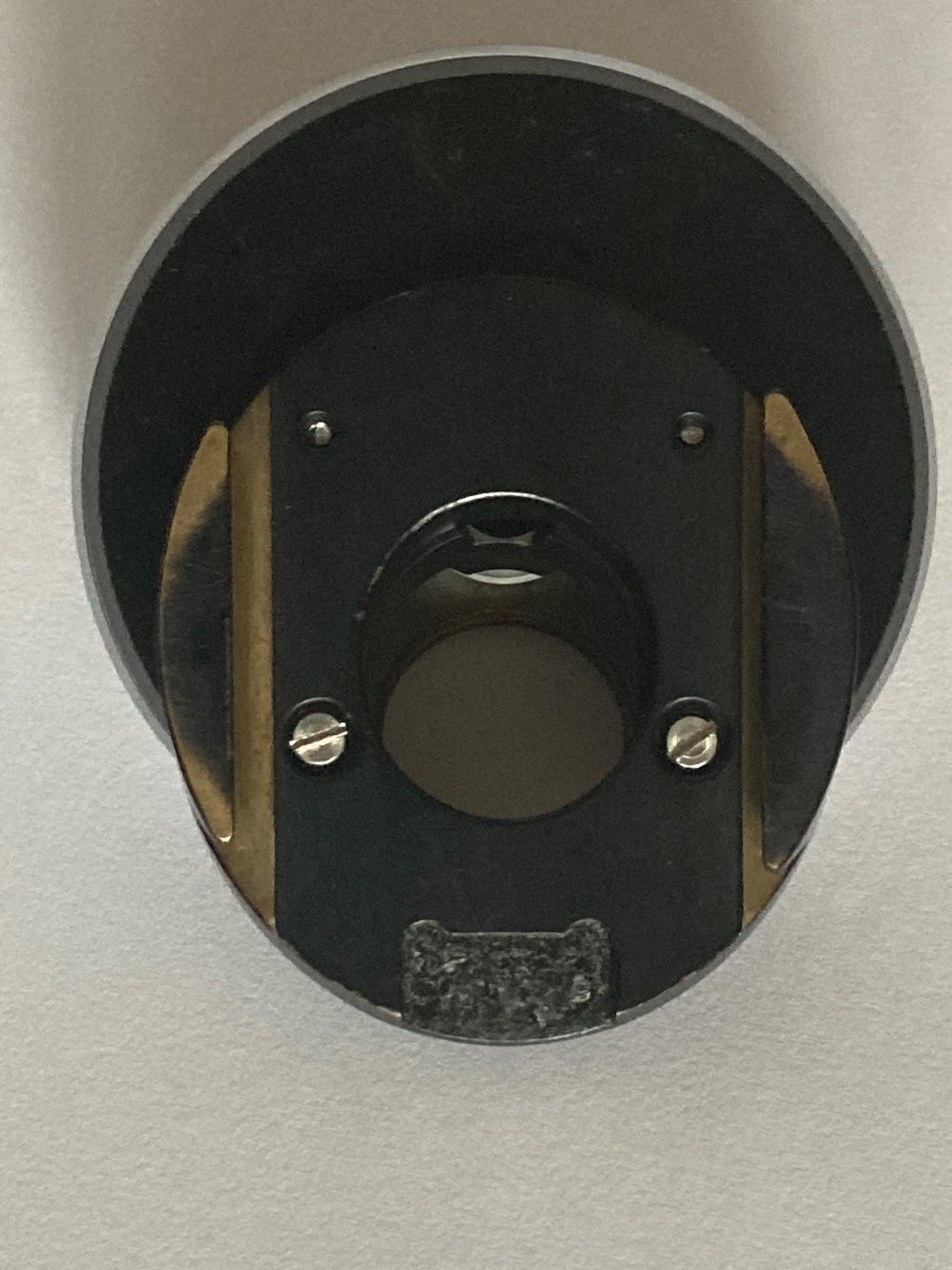

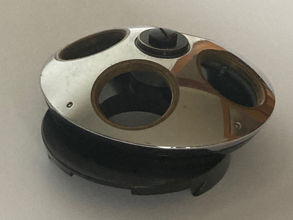

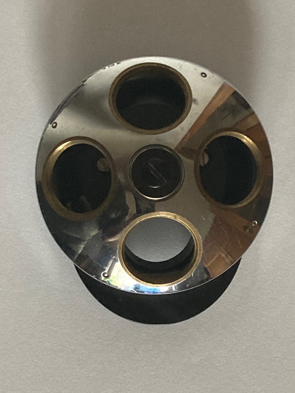

I use mine on my universal with the epi-condenser and H-Pol insert, usually with the INKO prism for Epi-DIC.
Adam Long
Harry,
Length from base of threads (inc cap): 20mm
Overall length: 32.5mm
Working distance: the 2mm specified by Zeiss looks to be correct.
Some pictures:
