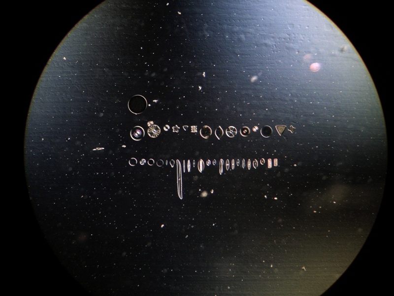

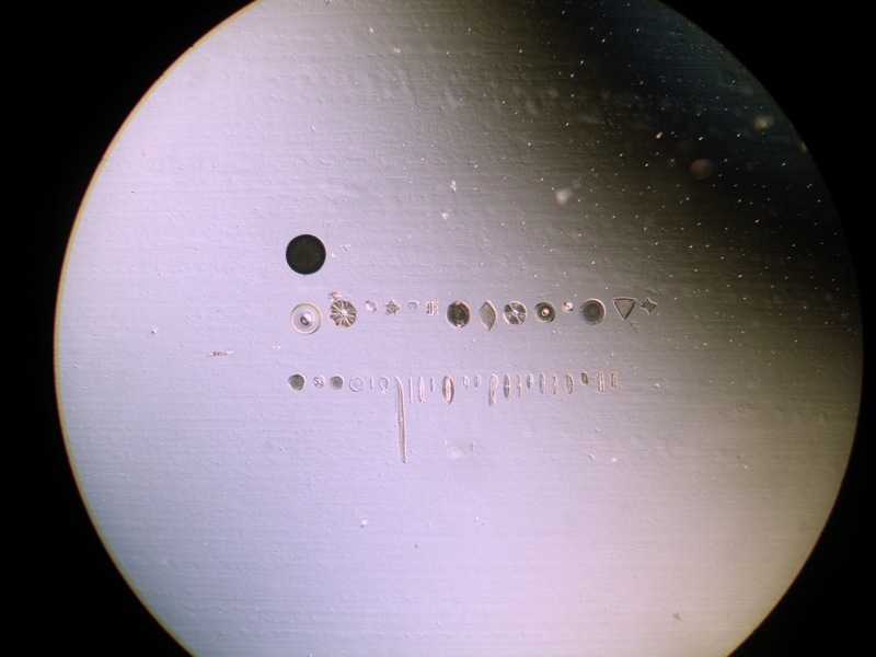

I am trying to get my Standard-DIC fitted with the right lenses, but do not know how perfect the homogenity of the background can be.
This is a planachro 6.3x (new Zeiss logo) with the middle-old DIC (condenser prism IIII, 0.63 nA pol toplens, exact Koehler position, tube-slider III). Objective performs perfect in brightfield, but gives inhomogenous background in DIC.  Is this acceptible or should I hand it back?
Full extinction setting:
work-setting, little bit heavier on the image then visually:
Thanks, René

Hello René!
I just started a thread a couple of days ago in respect to the "old DIC" from Zeiss. You can find it here: http://www.mikroskopie-forum.de/index.php?topic=15037.0
It would be great if you could contribute with your pictures and comments there - as the intention of this thread was to establish kind of a "reference-library" of combinations from lenses and prisms of the "old DIC".
Regarding your pictures: In my opinion they look pretty ok (especially the first one). Maybe you can achieve somewhat more homogenious background by lowering the condenser a notch or two... As I found out, in respect to DIC, it is somtimes appropriate to move away from the "exact Köhler" illumination. I usually start at "exact Köhler" and then try to modify condenser or aperture settings to achive maximum contrast and homogenity of background.
Hope that helps!
