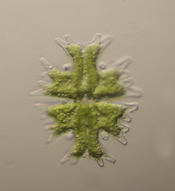

Jan l'Amie
Micrasterias thomasiana

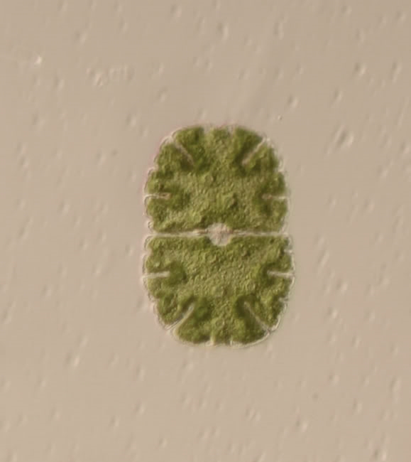

Micrasterias rotata

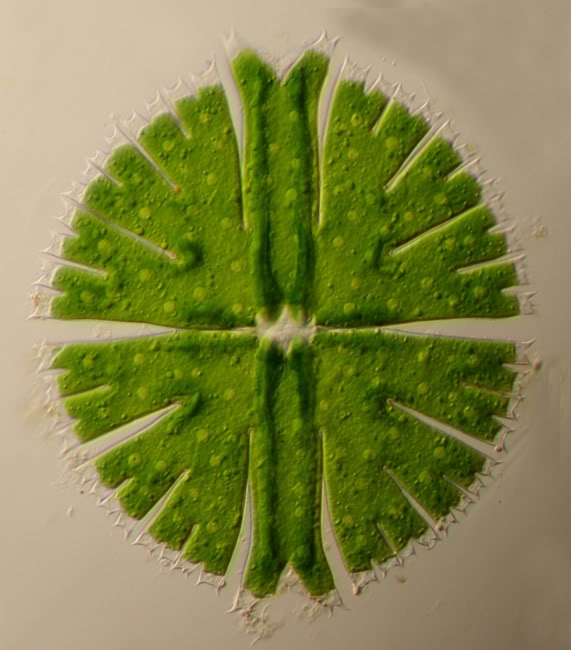

Micrasterias papillifera

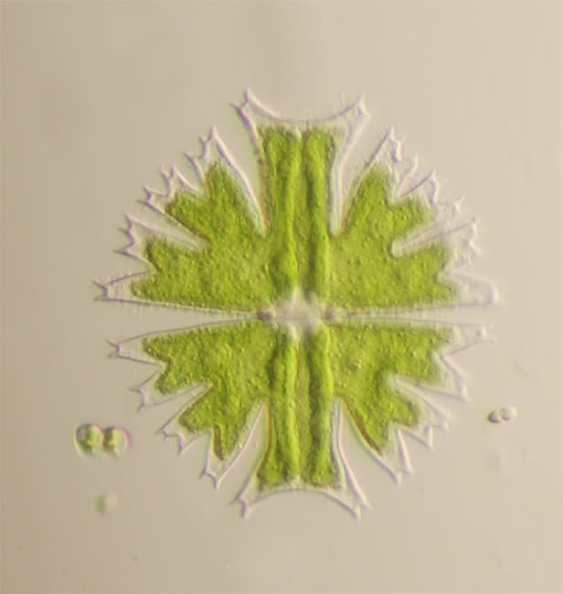

Micrasterias jenneri

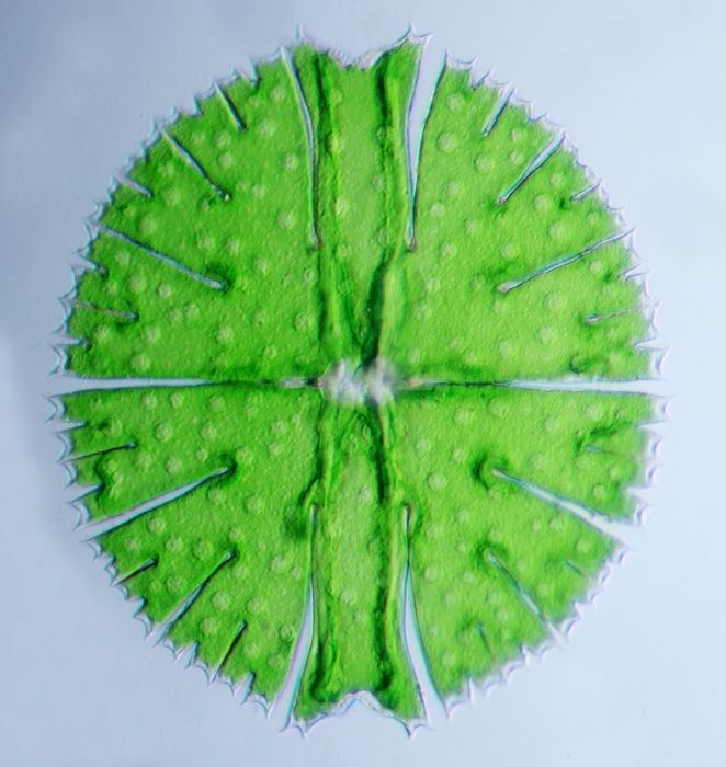

DIC microscope and a desmid is not a realy flat object, so if it is not
100 % horizontal unther the microscope you can get some unsharpness.
In that case you can better make some stacking pictures.
Stack of five frames:
