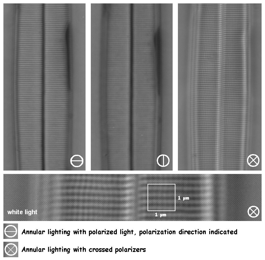

No, just a polarizer is enough: here the visibility of the striae/pores depending upon the polarization direction of the illumination. Polarizer was placed beneath the Heine condenser.
Also the direction of the valve between crossed polars is critical.
Best wishes, René

Hello René
your explanation was just right for me. With the Heine condenser and a polarizer, I could see the difference in the 90 ° positions very well. Once only the strips and then the pores. Although my camera has pixels with 2.2 x 2.2 µm and otherwise behaves well, I have to consider getting a new, sensitive and faster monochrome camera. Thanks for this explanation and the pictures.
