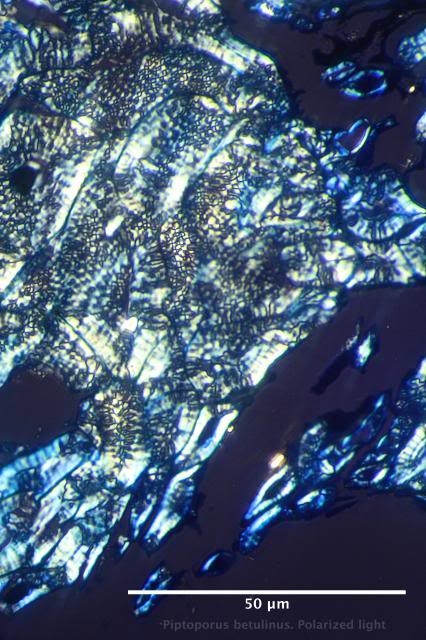

, Pores of P. betulinus vary widely in size from 100 to 250 um.  They are surrounded by tramal tissue consisting of thin walled generative hyphae intermingled with thick walled structural hyphae. Structural hyphae could be  made visible under polarized light suggesting the presence of a high concentration of crystalline cellulose in their cell walls   The staining by toluidine blue at pH 4, which does not stain crystalline cellulose,  shows only thin walled hyphae ,
Crystalline cellulose is double breaking and can be made visible in polarized light. The picture shows the presence of crystalline material along the wall of the pores, rather suggestive of cellulose enforcement of the pore structure. It cannot be excluded however that  these big crystals were linked to the pore wall after sectioning and are not representing the thick walled hyphae.
I have not seen any basidiospores, but studying larger magnification of the polarized light pictures, one can see small tetrades suggestive of the 4 sterigmata on the basidia that are normally connected to the 4 spores. It is remarkable that these sterigmatal traces are found in the tramal region and not in the hymenium where the basidia are located.

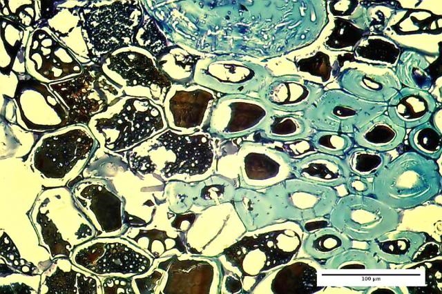

Piptoporus is a brown rotter because it degrades cellulose and leaves lignin almost intact causing the wood of the infected Birch to gradually turn brown. Crystalline cellulose is rather resistant to the hydrolytic action of Piptoporus (Valaskova & Baldrian, 2006). In the stipe by which the mushroom is connected to the host tree, I found pieces of the bark, like the sclereids shown here. The structure of the sclereids seems strongly affected by the hydrolytic action of Piptoporus enzymes . The image made of the same slide using polarized light shows the presence of double-breaking crystals . These crystals could be derived from the crystalline cellulose of the degraded sclereids. Higher magnification   under polarized light showed fracturing of the sclereid structure .
For comparison I have added a picture of  Birch bark infected by Chaga (Inonotus obliquus) another Polypore fungus. Inonotus causes severe brown rot of Birch and induces formation of big tumors (conks) on the tree that consist of both bark and fungal tissue and are strongly melanized. Sclerenchym and sclereids are affected by the action of the fungus. Chaga is a well known medicinal fungus, its extracts are sold for high prices.
