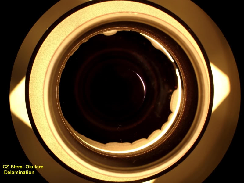

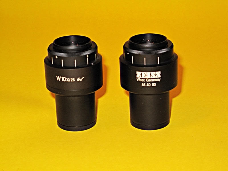

If I am allowed to go back to the original discussion, I have no wish for Lenstrennung. Now I have this problem of the Stemi oculars Herr Herrmann shows. And I have got some very thin UV curable acrylate glue that I am using here to glue the coverglasses to the sedimentation columns. That works very nicely, it creeps in every capillary space, very strong, hardly shrinks, clear as glass!
Now, the RI is not entirely similar, RI is around 1.49 or so (of what I found on the web about it). But would that show up at these levels of delamination?
What about Norland UV-curing lens cement, has anyone tried to apply it on this kind of delaminated optics?? See for example https://www.norlandprod.com/adhchart.html
Plenty of choice. Does anyone actually know for sure what RI to choose?
Best wishes, René
