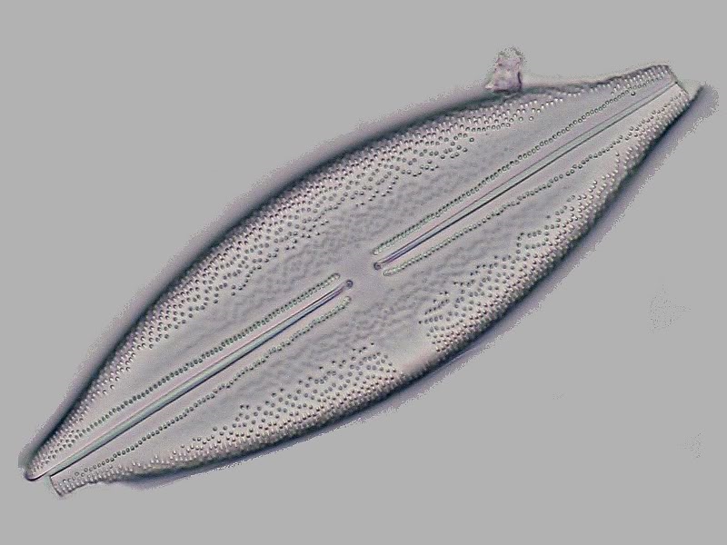

die Diatomeenprobe vom letzten Herbst war so ertragreich, daß ich kein Land sehe. Ich bitte um Hilfestellung bei der Bestimmung.
Nitzschia panduriformis ?
Biddulphia mobiliensis BAIL ?
Diese hier dürfte den Vornamen "Navicula" tragen. Nachname "digito-radiata"?

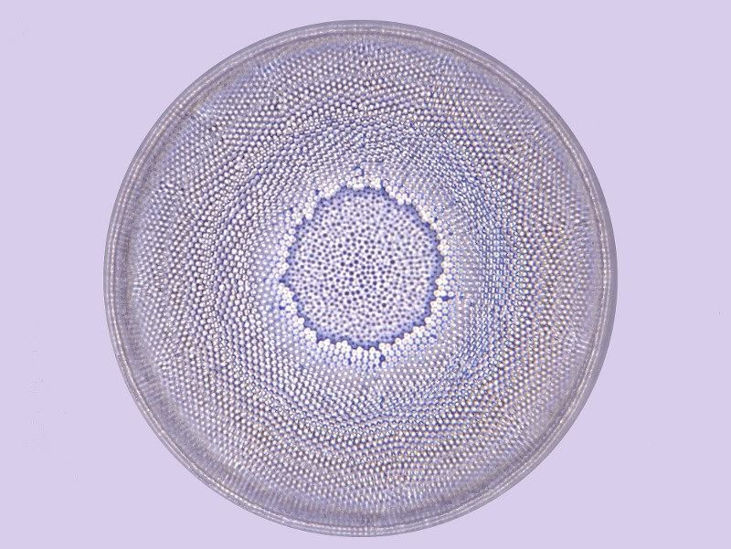

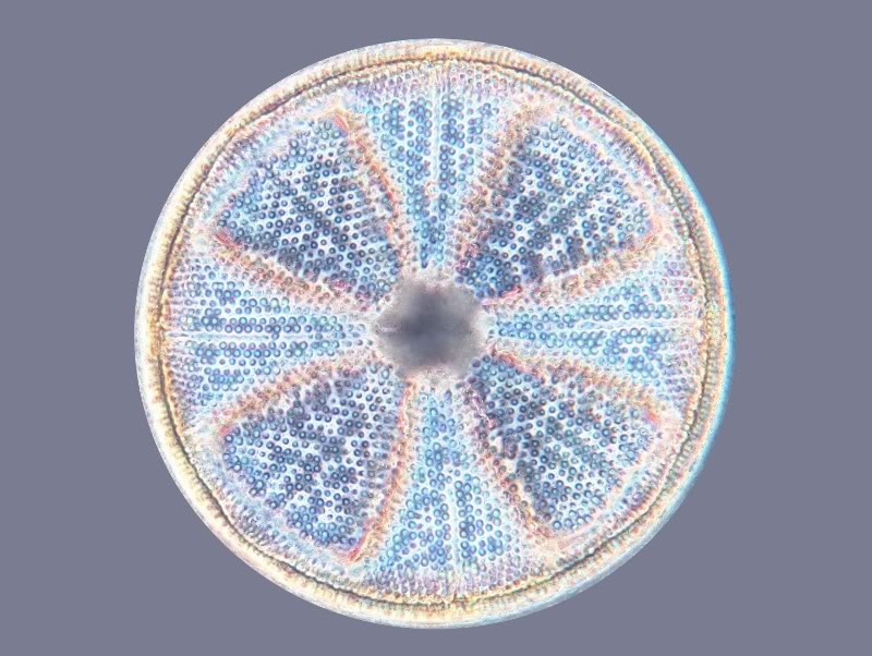

Actinoptychus ?
Podosira stelliger ?

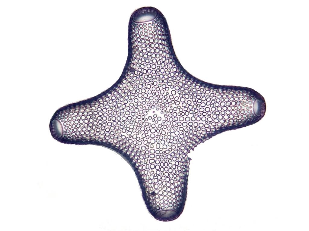

Bei den drei letzten Formen weiß ich nicht, wo ich nachsehen muss:
Vielen Dank im Voraus!

Hi Ulf, nice collection you have there. I'ts always tricky to get the names right, but I'll do my best:
1 Cymatopleura librile/solea (group) The holes and bumps are the 'wrong' way for a Nitzschia, it is surirelloid.
2 O mobiliensis, correct
3 Navicula, it certainly looks like digitoradiata The light dots in the middle worry me.

9 certainly Actinoptychus, but different from the ones we see overhere, it has processes and lines in the middle of the sectors which I never see in A senarius, but it does also not look like A. splendens.
10 P stelliger, correct

13 Trigonium zonulatum (?)

many thanks for your help. In fact this example of Actinoptychus is extraordinary. I found this one in one of my specimens I look at very often - and in fact it took me nearly one year to realize, that this one is different from the others  :D.

Päule Heck
Hallo Rene,
the last one is Amphitetras antediluviana Ehrenberg.
Look here: http://www.mikroskopie-forum.de/index.php?topic=1788.0
Best wishes
Päule
