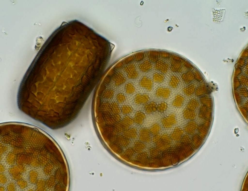

Got a nice fresh sample in from Antwerpen harbour. Who wants to take a guess? There's a free diatom slide waiting for the first who gets it right!
Best wishes, René
10x/0.4
20x/0.7
Bob
Hallo Rene,
ich würde sagen Stictodiscus.
Richtig?
Bob
Rene
TSchöll
Hallo Rene,
könnte es Stephanodiscus astraea sein?
Till
Rene
Auch nicht Till...

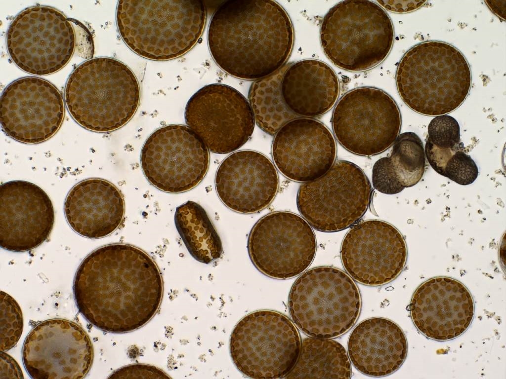

Tip: forget the Kiefern pollen!
Here's another crop with the essential details:
20x/0.7
Best wishes, René
martin_hu
Hi Rene
Aulacodiscus .....kittonii ....ev. crux
kind Regards
Rene
It's the right environment, Martin.
Getting closer!
TSchöll
Hallo Rene, noch ein Versuch. Last try. Is it Thalassiosira punctigera?
Rene
Leider auch nicht Till, T. punctigera is much finer areolated, with a completely flat valvar surface. Also, the Prozessen on this diatom are different and very unusual!

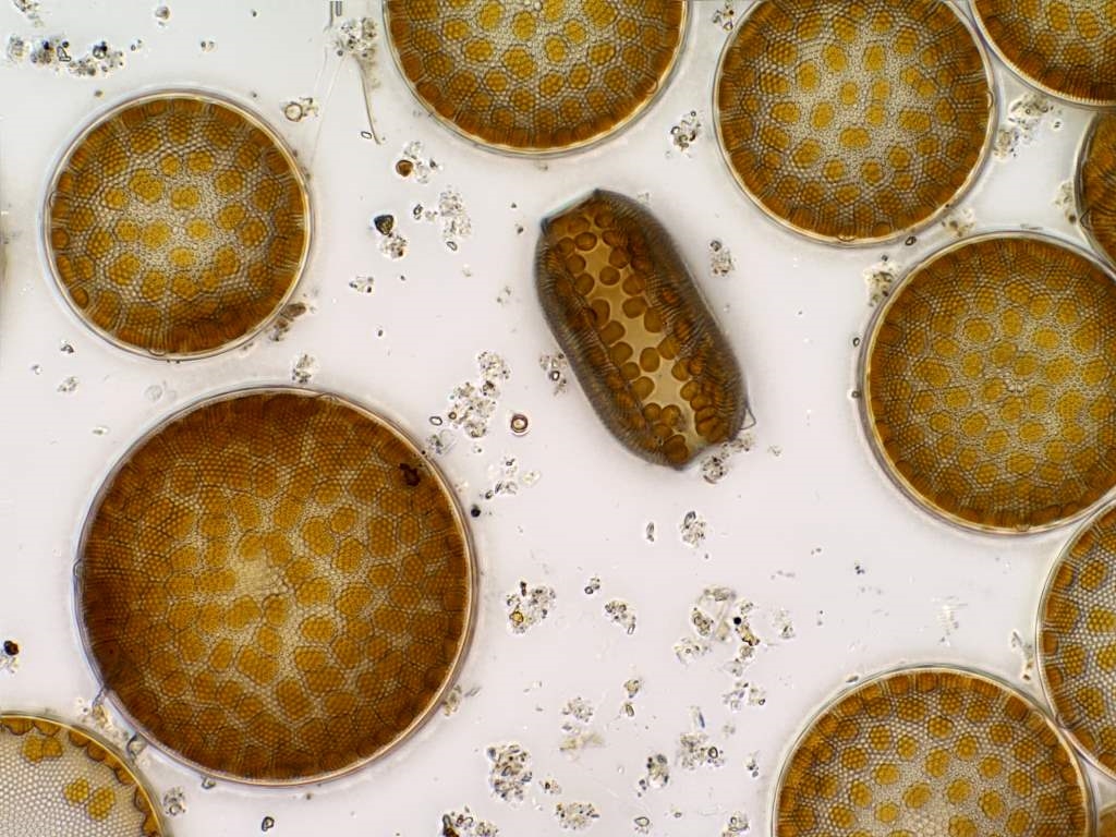

Rene
#14
And we have a winner! Coscinodiscus jonesianus var. commutatus, http://bibdigital.rjb.csic.es/ing/Libro.php?Libro=1006&Pagina=452, nowadays renamed Coscinodiscopsis commutata,  due to the two strange processes on the edge of the valve.
20x/0.7, cleaned diatoms
I guess Martin has earned himself a diatom slide from this massive bloom in the brackish harbour of Antwerp.
Now, in pre-Hustedt era it was known as a variety of C. radiatus , so  Anne and Paule could have been quoting from even older books. But without the mentioning of the variety Jonesianus, I cannot agree with it. The true C. radiatus is flat as a pancake (no stacking necessary, even with oil!) and, when alive, thin as a coin. That's a feature seldom seen by diatomists, with the old adagium: acid first, look later  ;D. Coscinodiscus granii is more like it, but has in girdle view a very characteristic asymmetric shape. And of course, they both lack the two very typical processes, of which the function is still unknown!
Martin, if you send me a PN, I'l send you your slide. Anybody else interested, I have slides to trade/exchange!
