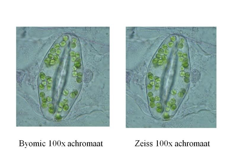

Hallo Holger,
I have a 20x, 40x and 100x objective of those. They give nice images. The incompatability with eyepieces that is being mentioned is a purely theoretical one and should not hold you back from your decision. I have good experience with using Olympus, Zeiss or no-name eyepieces on these objectives. I posted a picture in the "Bestimmungshilfe" section a while a go of a sample from the algae Melosira, that was taken with the 20x objective, have a look if you like the image. Also the pictures from the "Cyanobacteria" (that turned out to be something else  :)) I posted recently in the "Bestimmungshilfe"  section were done with this 20x objective. I have ordered the objectives from a dealer here in Holland called Benel: http://www.benel.nl/. Maybe you can contact them and ask if these objectives from ebay are from the same source. Furthermore, here is a comparison I made a long time ago between a Byomic 100x (importer name of these objectives) and a Zeiss 100x objective:
Best regards,
Hallo Rolf,
ich machs jetzt mal in deutsch, damit sich die Anderen nicht über mein englisch totlachen (Fürs Frühstück reichts aber!)
Wenn ich mir die beidenaufnahmen ansehe, so finde ich in der Auflösung keinen großen Unterschied.
klar, der Wissenschaftler oder Fotograf stellt da andere Ansprüche; für den "Dilletanten" reicht es allemal, es ist immerhin 100x!!

wenn man sich aber die Bilder auf Rolfs Link anschaut, sieht man da erstaunlich wenig bis gar keinen Farb- oder sonstigen Fehler, auch nicht am Rand.
